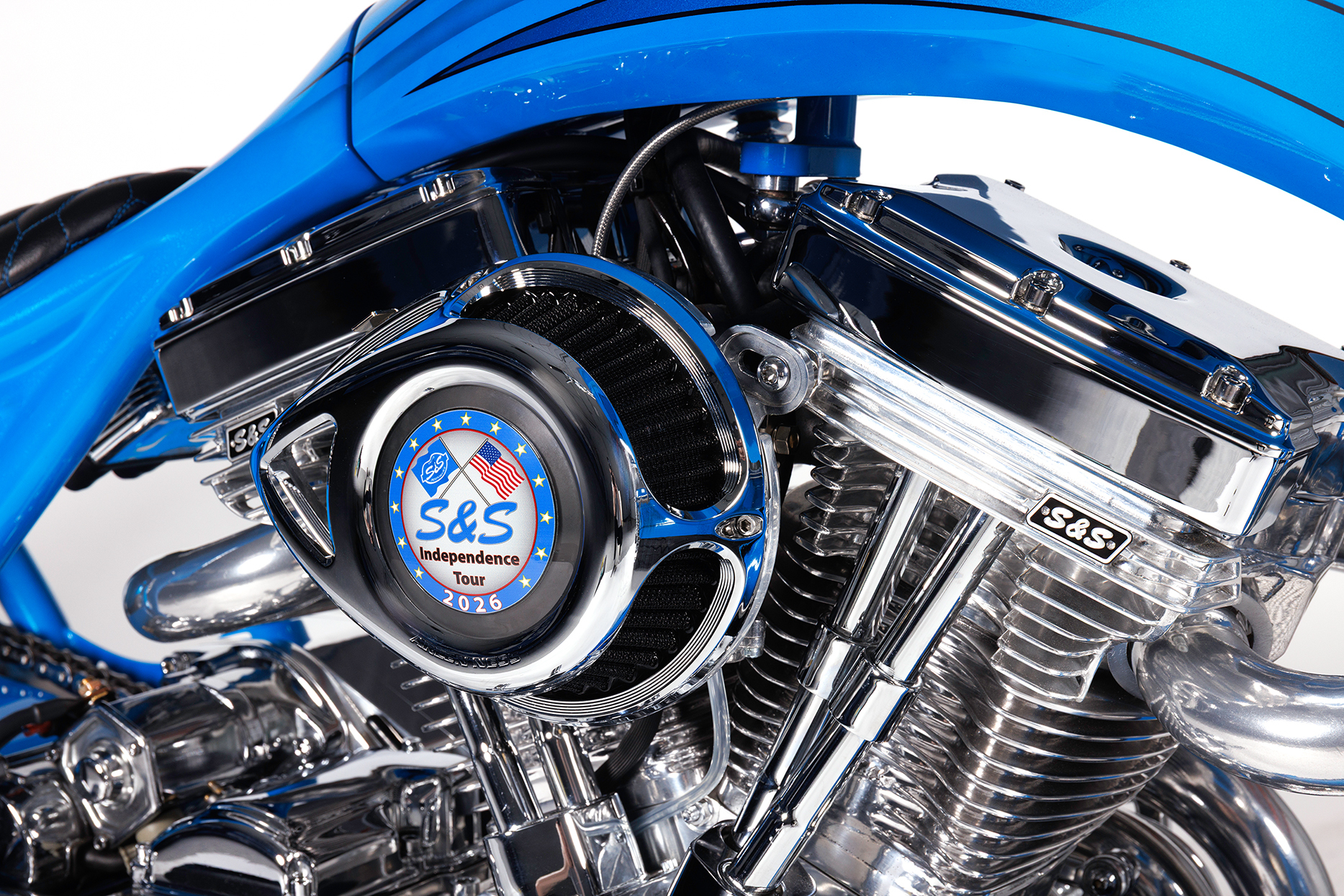

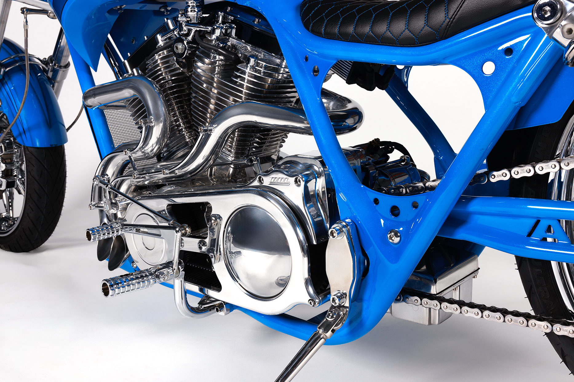

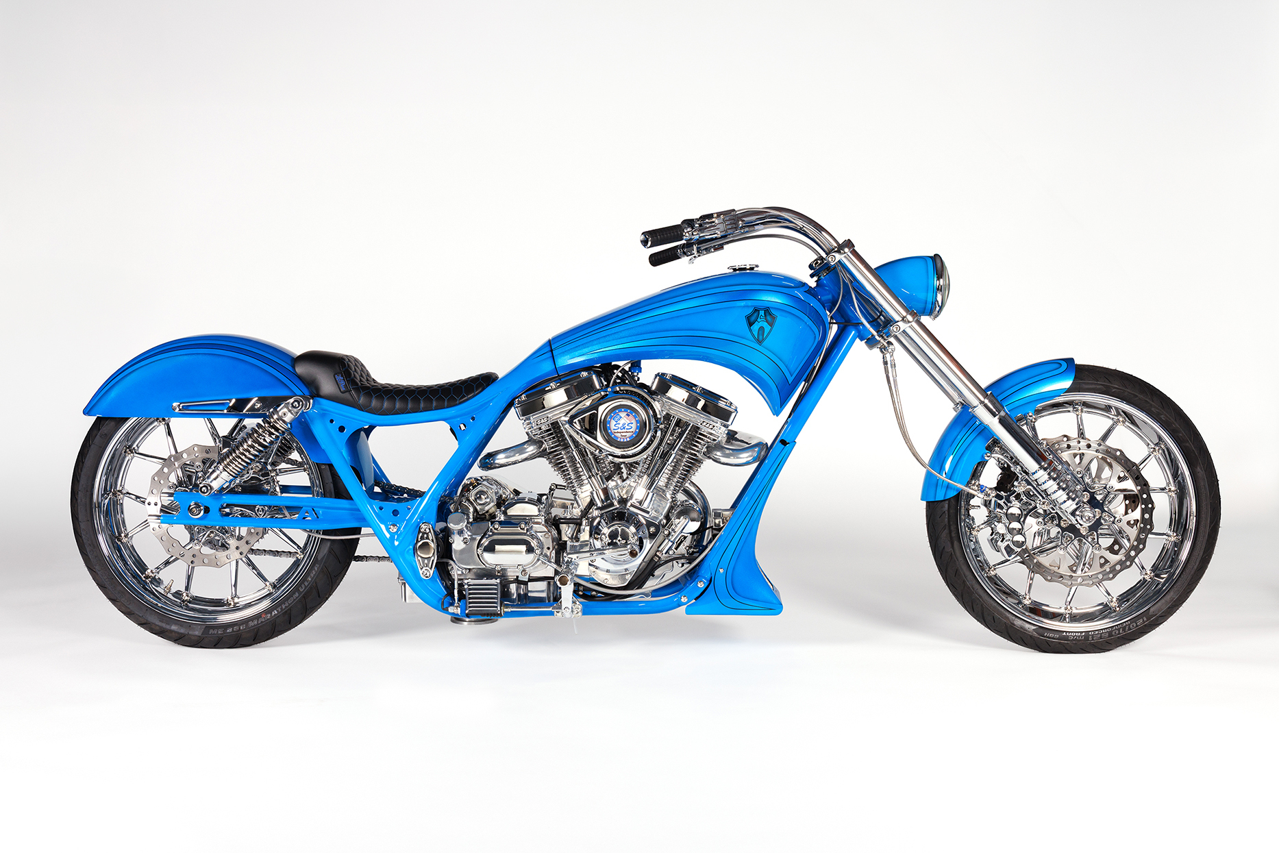

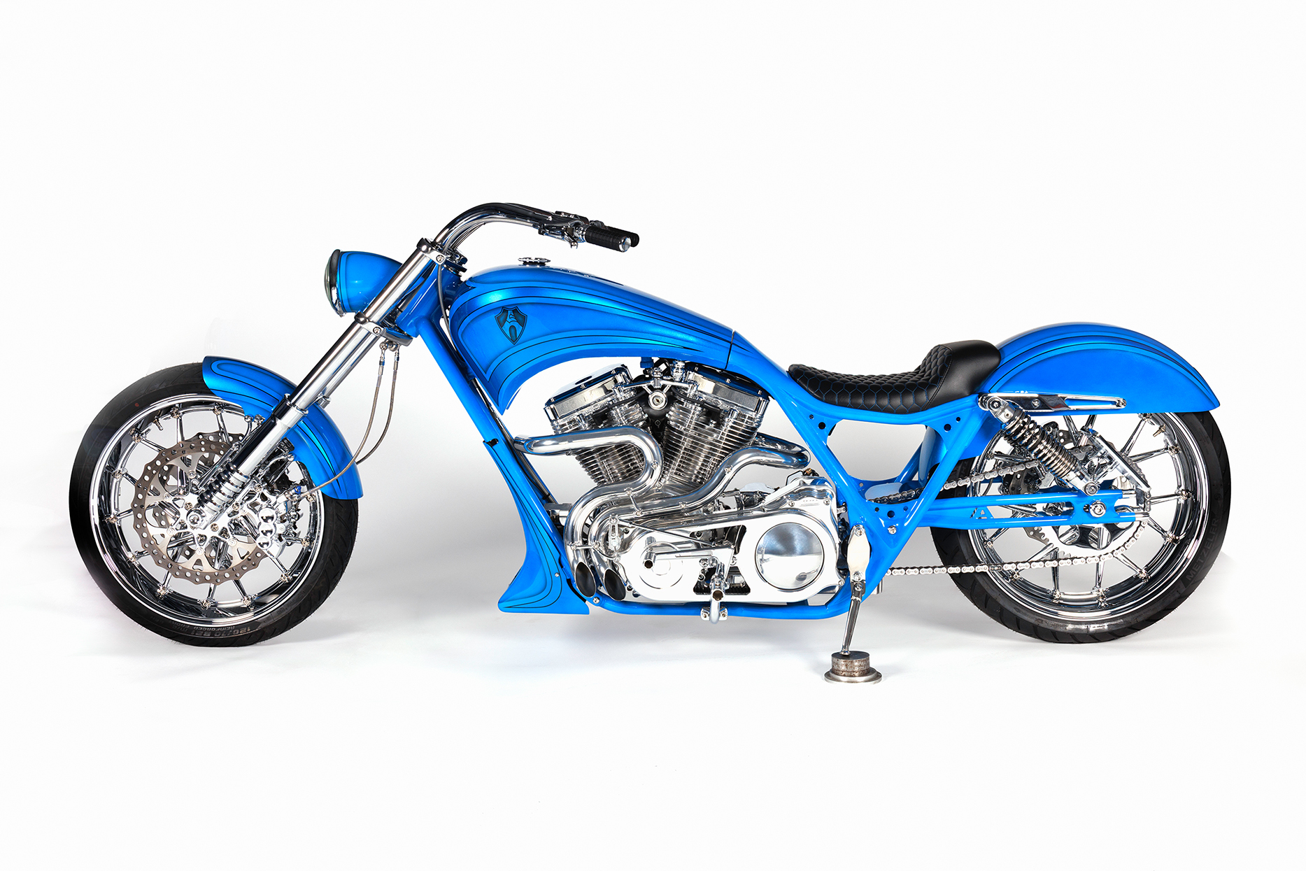

Cory Ness built his beautiful bike with our S&S Cycle V-Series 124. Naturally he
customized the FXR frame with some Ness magic, reversed the exhaust out to the left
side of the bike and used an FL-style transmission to hide the oil tank. He had his mind
set on leaving the side panel triangles open to draw your eyes in and make you wonder
if the bike was complete. By hiding the battery and electronics in the chin spoiler he
accomplishes his goal.

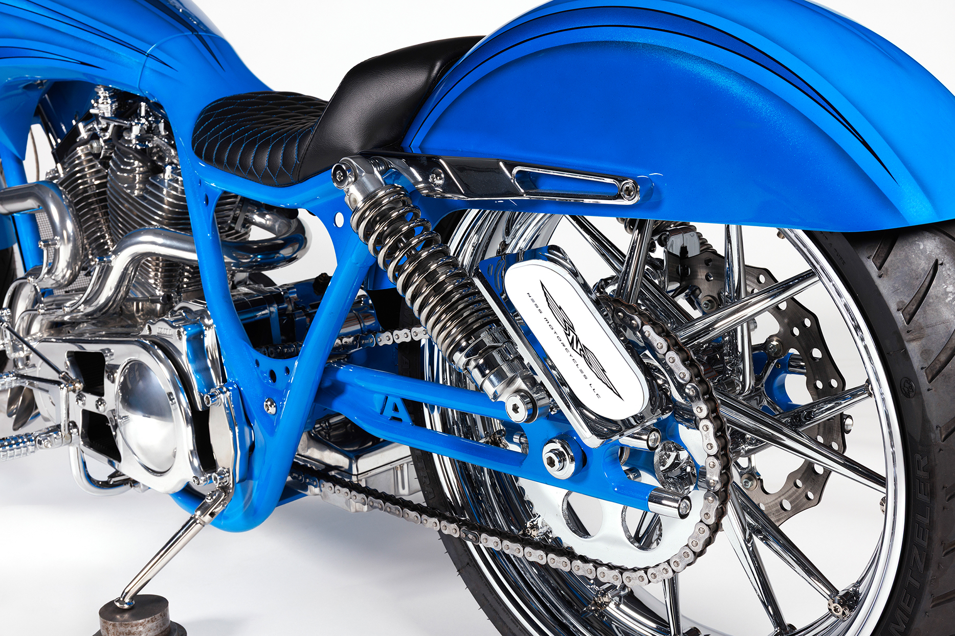

The swingarm is a hybrid Ness Dyna-style grafted onto an actual FXR section,
emphasizing just how custom everything on this bike is. If you look closely at his bike
you will find a number of old Ness billet components from the 90s that Cory sourced
from all over the internet and world to add some period-correct cool to his build.
