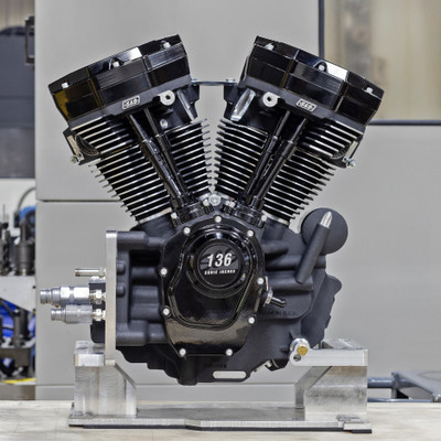

•    PN 310-1296 Engine, Assembled, MK136B, Black Edition, Oil Cooled, 475G Cam, Black,
2018-up M8 Softail®

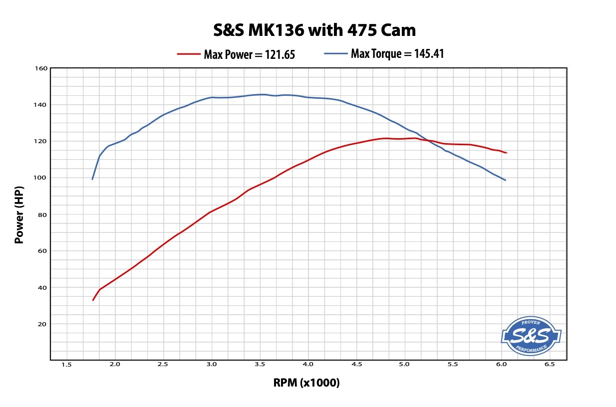

    •    PN 310-1295 MK136B Engine with 475 camshaft, Stock Throttle Body, and 5.5g injectors
    •     Exhaust - Stock H-D catalyst header with S&S GNX 4.5” mufflers
         ◦    DB inserts installed
    •    Air Cleaner - S&S Stealth with stock or +1 air filter
    •    Run this specified combination to be emissions compliant
