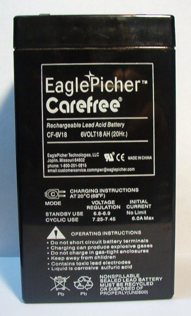

I went with the sealed battery offered by Interstate batteries. It is a CF6V18 and you can get them at Auto Zone parts stores. Their rated at 18 amps and will fit perfectly inside an old H/D battery. I’m using a 15 amp fuse with mine. I also like that they are made locally in New Castle PA.

That is really cool Steve. Any sign of leaking yet ? My WLA does not have a fuse. Did your WL come from the factory with a fuse holder ? If it did not come equipped with a fuse holder, what made you consider using one ?

No leaks and it holds a charge much better than the vented battery ever did. I took it out of my 45 last fall and put in the cellar for the winter. After setting all winter it still had a full charge in it this spring.
The fuse is there because I just got in a habit long ago of installing one anytime I needed to completely rewire a bike. I hate doing electrical stuff and don’t trust myself to not cross wire something along the way. The fuse is sort of my insurance policy against my lack of experience when doing a complete wiring job.
