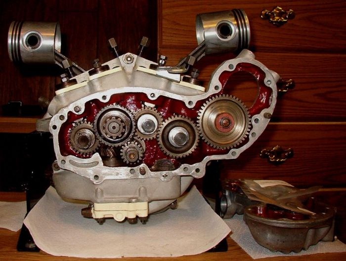

I may get some of this build mixed up chronologically but it will be pretty close in terms of sequence of build events.
I think I may have set my next sights on rebuilding my 32E generator at about this time. After all, I could not complete the engine without generator shim specs to the gear case.

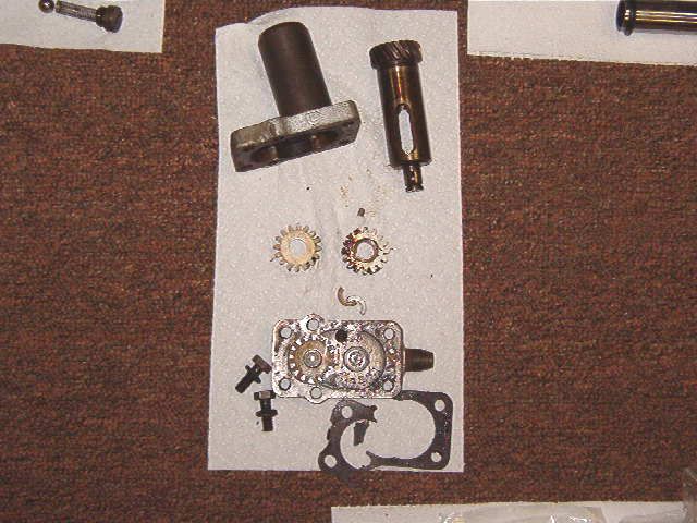

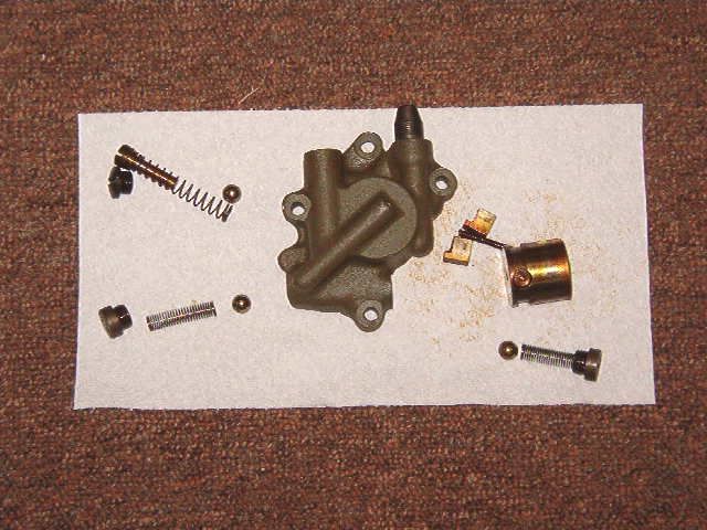

With the genny completed I went ahead and disassembled my nos scavenger and feed oil pumps. They really packed the cosmoline into them so they had to come completely apart. I would paint the pump bodies white as well since my wla would have come with white painted oil pumps and not an olive drab painted feed pump, nor a silver painted scavenger pump as my nos pumps came out of the mil spec packaging and civilian packaging. I can’t seem to locate the newly painted oil pump pics I took but you will see both pumps installed later in this topic. I also overhauled the timer at about this time as well but can’t locate those pics either.
Scavenger pump disassembled
Feed pump disassembled
I replaced the nos scavenger pump cover with an nos oiler cover though the scavenger pump oiler cover is not shown in the pics. I replaced the cover at a later date in the bike build

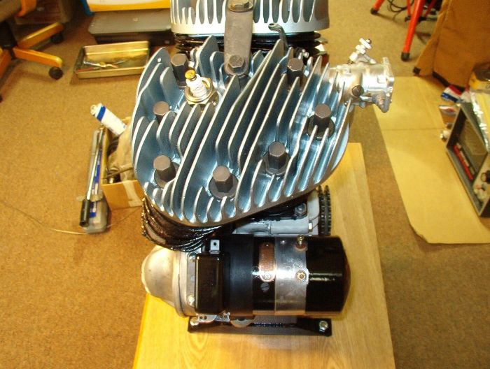

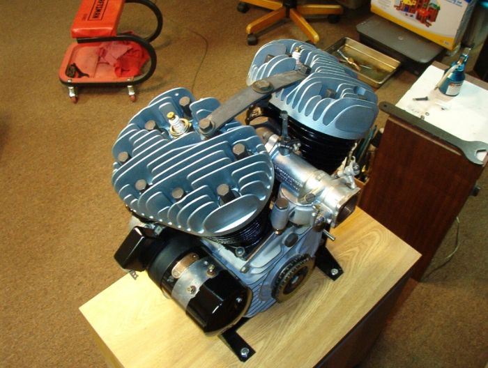

With the generator and both oil pumps ready for installation, I could now install the cams, idler gear, pinion shaft gears, tappets and tappet blocks, scavenger pump + time the scavenger pump breather, install pistons and rings, timer stop bracket, etc., and finally button up the bottom end of the engine.
I had already fitted the pistons and rings to the cylinders at an early date.
I could now install the gear cover, cylinders and valve stem covers. I left the cylinders loose until I was ready to install the intake manifold.

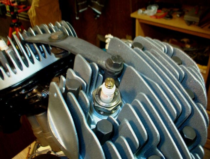

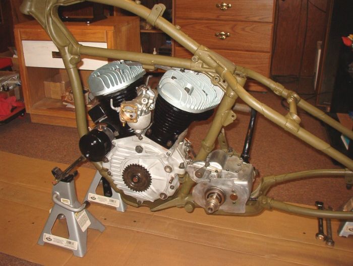

The engine build picked up speed at this point. Gear cover, heads, intake manifold, carburetor, drive sprocket, timer, top motor mount, and oil feed pump could now be installed etc.. I tighten everything up and adjusted tappets. Engine was now ready to be mounted onto frame.
I did however, at a later date in the bike build, have to replace the right front cylinder head bolt with the correct head bolt for the wla fording tube.

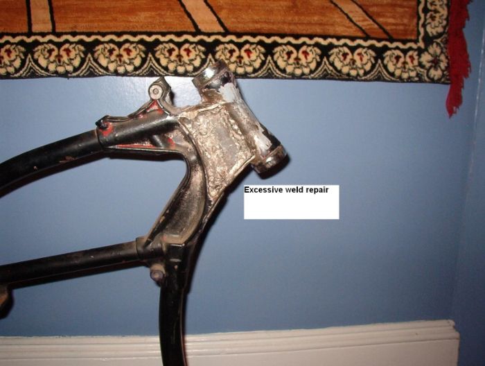

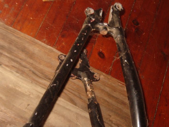

Earlier in this topic I mentioned how bad the original frame was and how the repairs to bring her up to par were extensive. Before I decided in excepting the deal with Bruce on another frame, I did an extensive inspection on the actual alignment of the complete frame down to every location of every single mounting tab, boss, motor mounts, axle slots, neck bearing positions, etc.. I turned a 4 ft. rod to fit the neck bearing cups so I could use it as a true path for a straight edge to the seat post tube and beyond. Using the service manuals to take inspection measurements, I found the neck tweaked at a severe angle which meant the springer and front wheel assembly would lean drastically. I also found the frame was twisted off inline centerline, front to rear, by 17/32”. It was this inspection that made my final decision to replace the frame. The frame damages you see in the pics below also helped me decide.
Note the missing tab on the lower right frame leg and how the outer skin is missing in that area as well.
Note weld repair in trans adjusting hole of rear lower frame fitting. I did not consider this repair a real issue since 45 frames are known for cracking at this location.
Look at how non-uniform in diameters the lower rear frame legs were. I did consider this as very troublesome.
The extensive weld repairs on the neck fitting was a real issue for me.
One of the axle slots in the rear axle fittings was opened up as well and would need replaced. I can't remember whether it was the left one or the right one.

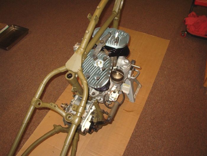

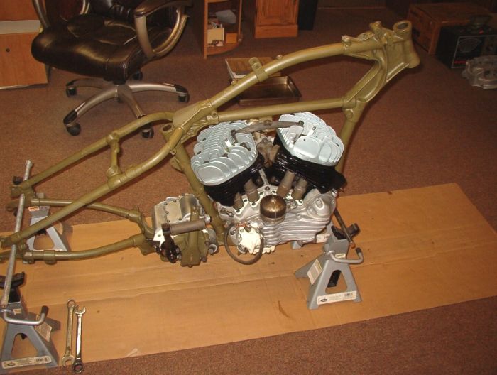

I still have not found my pics of my replacement frame as I hauled it home from Florida. However you will see it freshly painted as I mounted the engine and transmission into the frame. I supported the frame on jack stands at the front sidebar rod and rear axle slots. This would due for a spell until I got a bit further along with the bike assembly when the need to create space to add additional parts became necessary.
Post Sun Jun 08, 2014 6:11 am
Pa Site Admin
Posts: 5673

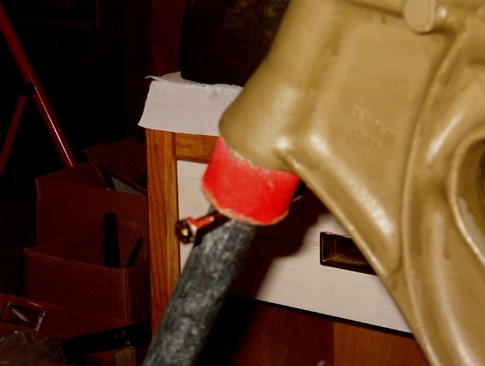

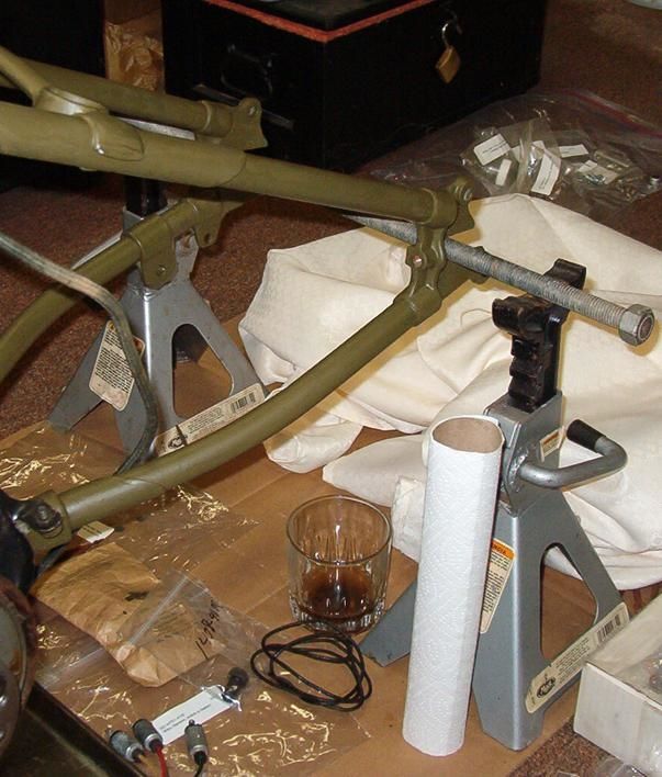

I then needed different support for the front of the frame for mockup tasks and my jack stands under the front footboard sidebar rod were in my way. I have an overhead lift but did not want to move it down here into the basement. I kept the rear jack stands with a 5/8" all thread rod to support the back end of the frame and came up with this plumber type solution for supporting the neck end of the frame. I used a combination of 3/4" black and galvanized pipe to put a front frame support together. Since I had not installed the bearing cups into the neck forging yet, I was able to turn part of the long section of galvanized pipe to fit. The frame head rests on a collar I found lying on the side of the road which apparently broke off of a snow plow. I leveled the frame so it would sit pretty close to where it would sit if being ridden. I then marked the length of pipe below the collar for the grade 5 bolt shown. With the black pipe T's, end caps, and 6" lengths of pipe assembled, the frame stands solid and permits me to work on the mockup assembly tasks. The pipe end caps were added to increase the pipe end diameters to match the T's. The idea can be improved but as for now and for my needs, the improvised stand is just the ticket. Just thought I would share the idea. Total cost to put the stand together ??? Less than 20 bucks.

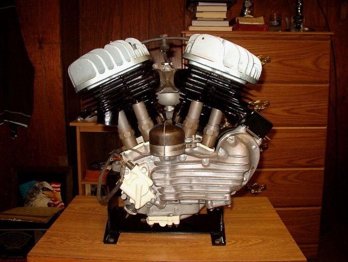

Before I forget, Below are the specifications on my engine rebuild.
Crankcase
Rod roller bearings on crankpin clearance, all three sets = .0008"
Rod side play between flywheel halves, = .008"
Gear shaft main roller bearing clearance in case half bushing, = .0009"
Sprocket shaft main roller bearing clearance in case half bushing, both sets, = .0007"
Flywheel assembly endplay clearance in cases = .009"
Gear shaft clearance in cam cover bushing = .0008"
Rear Cylinder
Exhaust valve stem to valve guide clearance = .0042"
Intake valve stem to valve guide clearance = .0035"
Piston clearance to standard cylinder bore = .0015"
Piston ring gap clearance in cylinder bore, all three = .011"
Front Cylinder
Exhaust valve stem to valve guide clearance = .0041"
Piston clearance to standard cylinder bore = .002"
Piston ring gap clearance in cylinder bore, all three, = .010"
Tappet to Tappet Block Clearances
Front exhaust tappet to guide = .0006"
Front intake tappet to guide = .0006"
Rear intake tappet to guide = .0006"
Rear exhaust tappet to guide = .0006"

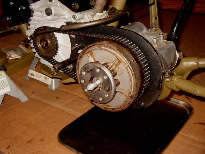

I then decided to install the inner primary cover, clutch cable and housing, clutch hub, clutch hub bearings, bearing gage, clutch shell, clutches, clutch steel discs, pressure plate, clutch springs, primary chain, ect.. Every single part being nos.

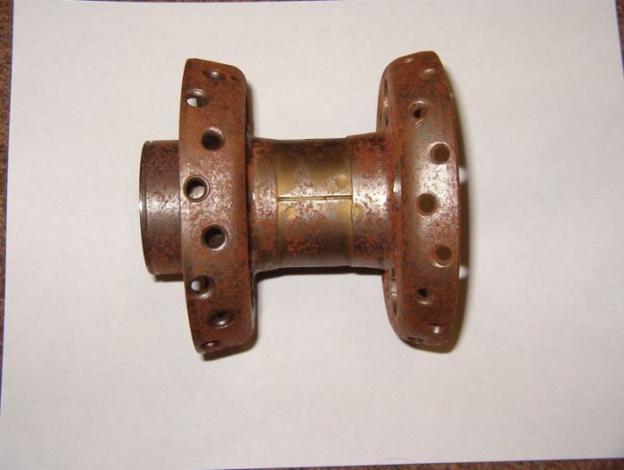

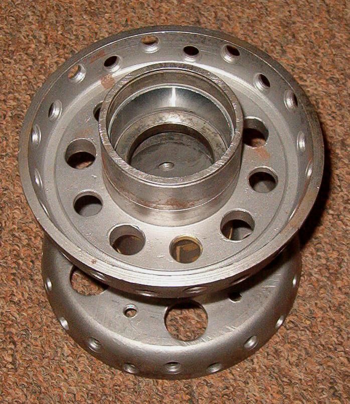

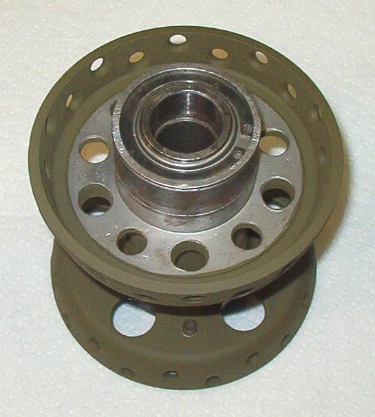

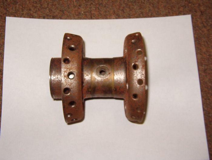

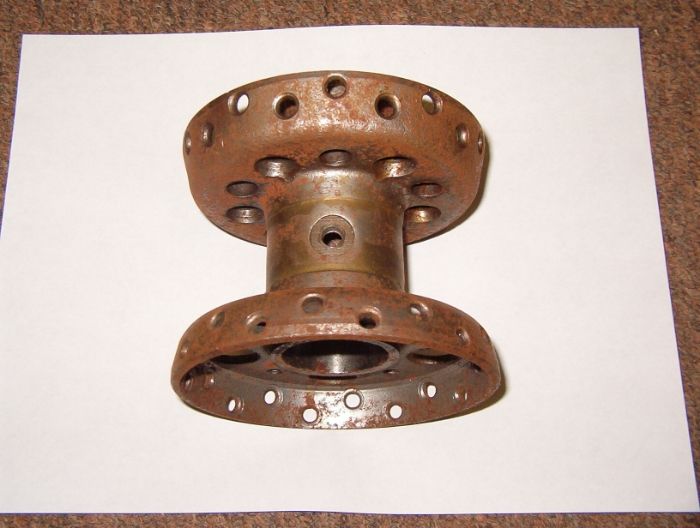

I decided to get some wheel work out of the way. I started with the rear wheel. After careful inspection of my hub, it was obvious my races were way oversize. They were so far oversize I would not be able to fit oversize roller bearings to them. This is how the rear hub looked before I restored it.

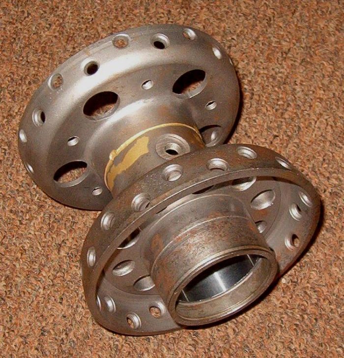

Luckily, I met this Bro here in Ohio who Grinds the old bearing journals and then he hard chromes the journal areas and regrinds them to standard size. He has been doing hubs this way for 20 years or so now and he has never had one wear. He and many people who had him do their hubs, told me only the rollers wear, not the hub races. My close friend had a hub done by him serveral months ago and I got an opportunity to inspect it. The workmanship was outstanding and the sizes were right on. I would rather change out rollers than change out hubs any day. Initially I was going to repair my hub races with the Sporster/45 rod race procedure. When I heard valid and trusting testimony to the hard chroming this Dude does, and when I actually got to inspect his work, I had to go that route instead. It just made sense. Below is my hub as received after the bearing race hard chroming and grinding.
The grinds were right on standard sizes which made it simple to fit rollers to the races and inner bearing sleeve. Below is how my hub looked after fitting endplay, roller bearings, the rest of the hub components together. Finish specs are noted as well.
Here are the nos and oem rear hub parts which went into my rear hub.
And here are the restored hub fitting specs.

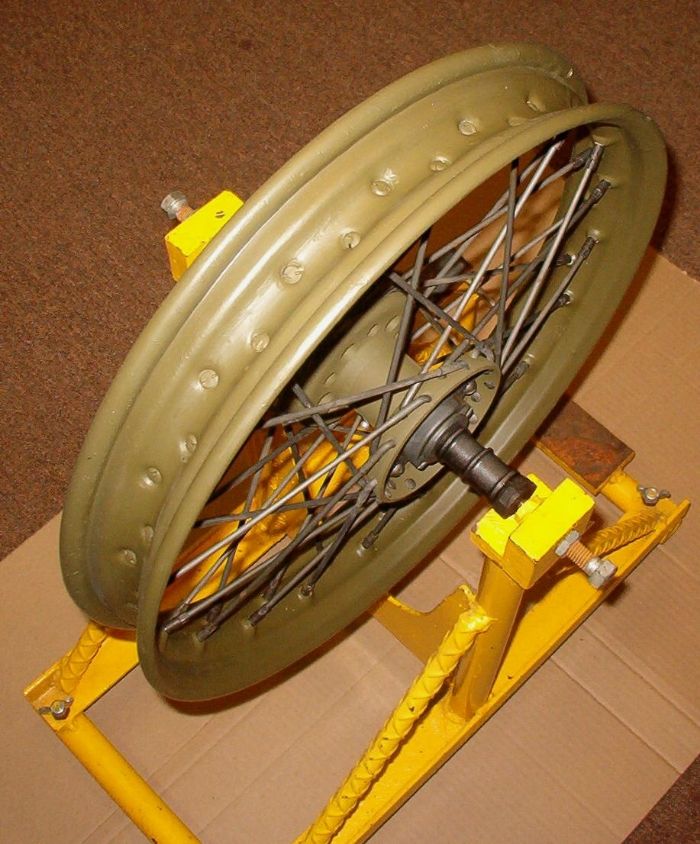

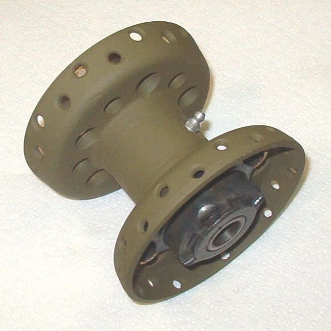

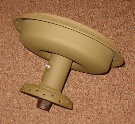

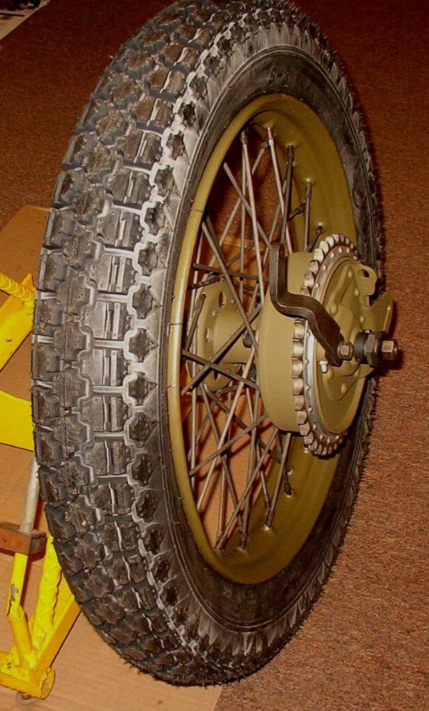

With the rear hub now restored I could now lace it up to my restored oem rim and my nos spokes and nos nipples and true the wheel. I had to re-parkerize the spokes and nipples and I also had to beat a bunch of dents out of the rim. You don’t see the dual dial indicators I used mounted on my home made truing stand that I used to fine tune the truing specs in the pics. I got the wheel trued in below .015” all over.

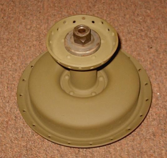

I figured I might as well assemble my restored brake drum, restored brake backing plate and its’ all nos components, the reproduced tire, inner tube, and rim strip, to the trued rear wheel. The oem wheel lugs you see in the pics are later wheel lugs. I replaced them with the correct earlier grooved wheel lugs at a later date. Our forum member “Robbie” donated those to me. Thank you Robbie ! The tire tube valve stem was later cloaked with a real nice Schrader valve copy covering I picked up from “Old Dude” in Georgia.
I then restored my nos front brake drum and hub assembly and laced it up to my nos front wheel rim, nos spokes, and nos nipples. As with the rear nos spokes and nipples I re-parkerized them. The front nos brake drum and assembly was a piece of cake to restore. I had to clean out globs of cosmoline and repaint but I had to do absolutely nothing to the bearings and internals except for adjust the free play. As for lacing and truing the wheel I re-parkerized the nos spokes and nos nipples and the nos rim trued easily. Also as with the rear wheel I installed all the other components. I Installed my restored nos front brake backing plate and assembled all nos components inside and outside. The wheel trued to within .009” all over. I completed the front wheel with a reproduced tire, inner tube, and rim strip. I also installed one of those Schrader valve stem covers at a later date. Sorry….no pics of the front wheel lacing and truing during this period. Nor will you see the completed front wheel pics. I cannot locate them. You will see the front wheel later in this topic.
Restored front brake hub assembly. Nope….that is not rust you see on the lining surface of the drum.
