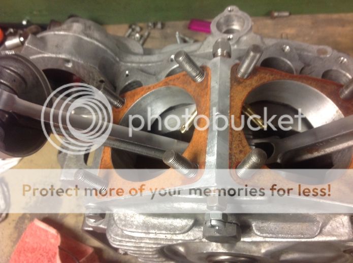

so, the stroker bike is back on the workbench
here's the piston oilers, T&O pistons and rods... no baffles! Hasting 3-piece oil control rings to follow.

Interesting setup 45brit.
How do you keep piston and cylinder skirt clearance to the skirt oiler?
Cut off in both?
GuS
Post Tue Nov 11, 2014 6:16 pm
Posts: 1646
That's correct. The design is based on infirmation posted here and eksewhere. Location is defend by having enough metal under the nozzle to ensure the integrity of the thread.
Haven't finalised where the feed will be derived yet but as I'm intending to use the Swedish Gerotor pump and high-flow return there should be some options.

Looks nice, clean install. Interested in how things work out with the gerotator pump. It definitely makes for a smooth installation.

Very nice looking piston squirters. I would do something like that if I did it again. On the Swedish gerotor pump there is a 1/8 npt plug that works good as an oil feed for piston oilers, however it is not controlled by a check ball. I put in an inline check valve that I got from McMaster-Carr and it worked for about 500 miles and then I began to get wet sumping. When I disconnected the oilers the wet sumping stopped. I am going to put a manual valve in the line this winter to solve the problem. The pump has plenty of capacity for the oilers and with them shut off, I am a bit concerned about excess oil pressure. The oilers bleed off enough to put pressures about where they should be.
Post Wed Nov 12, 2014 2:19 am
Posts: 1646
There is a post somewhere about having a pressure relief valve to control the oilers, I think 20psi was mentioned?
I've also seen mention of using a tee from the return line. I'm normally reluctant to divert oil from the feed line but it seems there is plenty of capacity. A return-driven supply would prevent wet dumping because the oil tank end if the line is above the level in the tank.

45brit
I must say your setup looks very clean.
Have you considered milling of the pistons on both sides leaving a narrow tang on the trust faces? By doing this you will have symmetric removal of material from the piston and also give room for the oiler. Of all the 45 pistons I have seen, there is never sign of wear on the sides, so why not remove this metal as long as you don’t hack of so much that you compromise stability and strength of the piston. This is being implemented in the motor I’m currently working with.
I have installed a valve on the line to the skirt oilers to avoid wet-sumping. Not so critical of I forget to open as it only blocks of the piston oilers. But I always remember as the manometer tells me…

I hadn't thought of milling them down to, effectively, slipper pistins, no. There's too much work in that engine already and I want to see hw it goes, first.
There is a possible later version with 38mm inlets and oversize valves, and THAT woukd be the time fir radical piston work.
