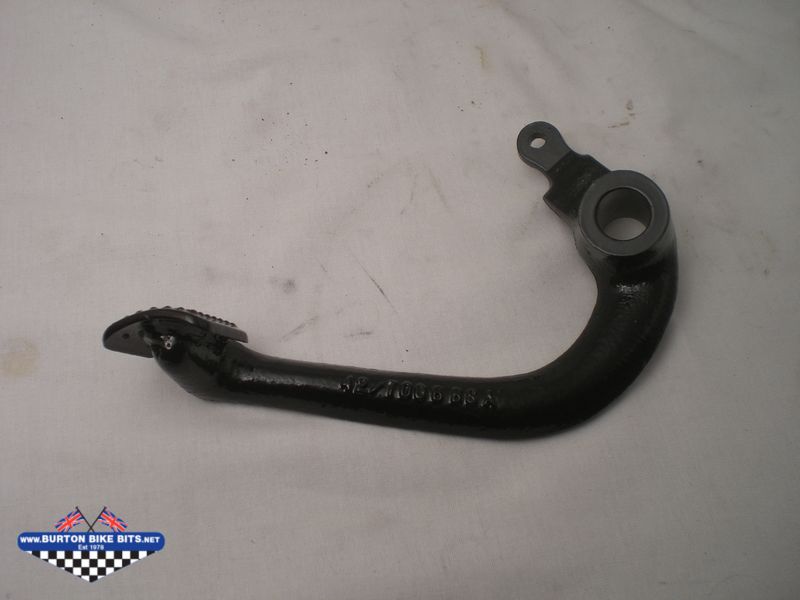

there was a long thread a little while ago about fitting BSA brakes in springers, but that's a very neat solution.
The rear brake crossover shaft arms look longer than you'll probably need in use. The original swing-arm BSAs had a cross-over shaft for the rear brake and the shafts were quite short http://www.gearheadauction.com/detail.a ... tolatest=7 , as were the brake pedal arms http://www.burtonbikebits.net/images/CIMG1705.jpg
45s also had a cranked cross-over shaft in the rear linkage and again, the arms are only about 60mm long.
