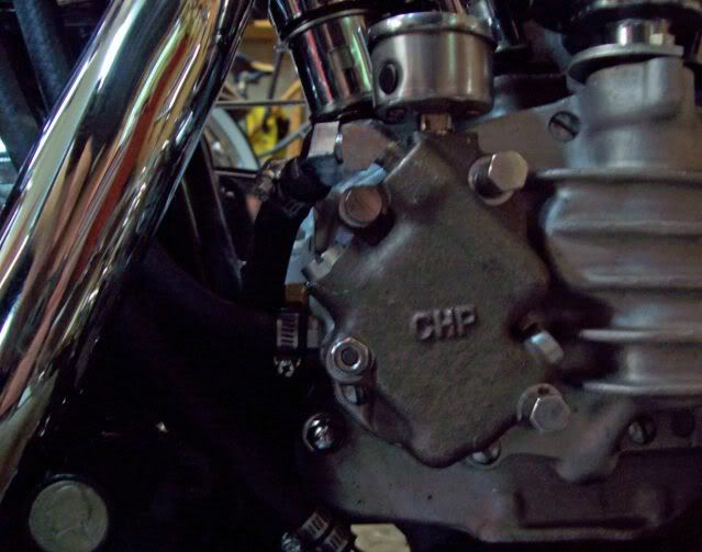

Re: http://www.vt-cycle.fi
All
I have put about 300 miles on the 42 since replacing the oil pump. Several miles were 55-65 mph for a sustained time. I can see no signs that the return pump can't keep up with the supply. After riding several miles the pressure seems stuck on 20 PSI. This is idle and at speed. It has sat several days with no signs of wet sumping either. At this point I would recommend the pump to anyone who wants to upgrade their system with no extra machine work.
Sounds good so far, thanks for the update. Looks like a clean installation. I had some trouble viewing online, so I downloaded the image to my hard drive and l
Using photobucket works a little better. I have never seen an oil pump with those markings before.
Chris Haynes
The pump came with instructions from these people.

Frankenstein
Thanks for downloading the picture. Sooner or later I will get the hang of posting pics.
