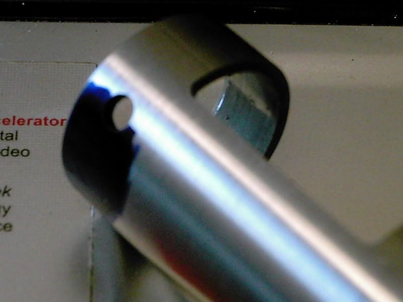

Having a little Oil Carrie over problem with this Repo 84" Kunck...
Doing a few old ideas for the cure....

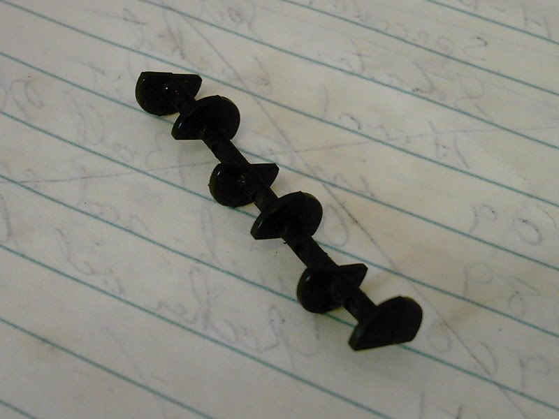

This is what I had in mind....
And also installing this 91 OEM part in the breather stand pipe in the cam cover.
And also one of these...
Being a S&S case, the breather window is pretty huge from the get-go..Was going to hook up a degree wheel and check the open and closing of the valve, But think that I would be beating a dead horse there.
If anyone has advice to add...I would love to hear what you would have to say on this problem...

Going to install a Don Hotop air ramp inside of the breather gear...Will be in need of drilling the scavenging vacuum hole for pulling oil from the cylinder heads in the ramp.
