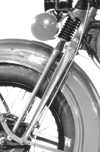

Does it look like this one? Notice the reinforcements where the spring fork tubes plug into the casting.

Thank you Chris and hdrl35,thats the one...i got an email also,the fork is the early 30`s Dl with the screw in bushings......my front part has that reinforcment also........
