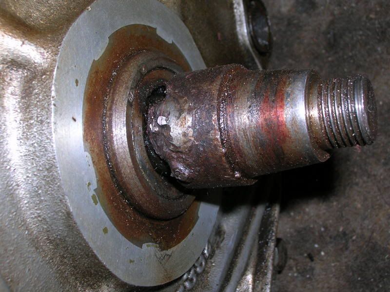

Well I was trying to work with what I had. I figured some points and a new condenser, clean the carb, new pugs, walla.... things got taken a little further.
I removed the engine and trans so I can get the frame in shape. I am going to go through the trans and the engine before I re-assemble, just to make sure all is well.
I found an ugly sight as I pulled the engien sprocket off...
I would imagine the balance of this is far from good. Maybe not...
surely this is not factory?
I am back to my first thougts- PANHEAD engine (sorry Fran). Its a special frame w/ some cool forks. Get the hand shift-foot clutch back together, some floor-boards and some fenders (stock rear (maybe bobbed)- custom front).
I will be keeping this little 45. It will go back on the frame to pull me around till someone tells me about where to find a 1948 FS / ES or FL / EL engine or I luck into one somewhere.
I wouldnt mind going for the full out sidecar set-up, but the sporty high compression mght be a little more fun.
Either way- I am looking for something 1948 panhead to put in it.
For now I am busy with striping the frame down, and ordering some gaskets.

So...what became of this project? Watched on both sites as bike unfolded.
Sprocket shaft scared me! Did it ever run again? Did you put some sort
of big-twin power in it?
