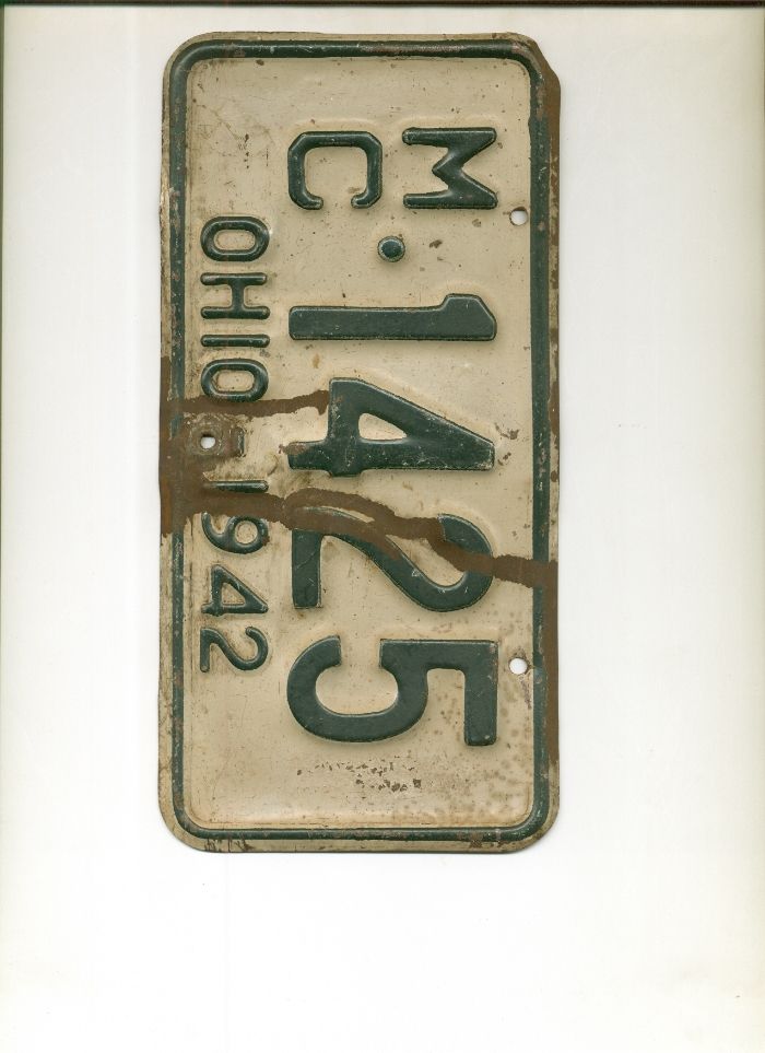

Went to the Wauseon, Ohio AMCA swapmeet and scored this jewel !! :D
It isn't pristine. I will need to fill one hole which does not belong in it. I will also need to repaint it. Is is however in really good metal condition with no rot, not bent, and only has one small kinked corner which is an easy fix. Anyone know what the green and white are called for a 1942 Ohio license plate ? Does anyone also know how the paint is applied so perfectly over the raised numbers and lettering on a license plate ?
Post Mon Jul 21, 2014 8:52 am
Posts: 540
Location: Wa, USA
http://www.oldlicensefarm.com/
I haven't used them but have spoken to them at swap meets and they do brisk business here and have a good rep.
Post Mon Jul 21, 2014 12:27 pm
Pa Site Admin
Posts: 5770
Thanks Woody. I will definitely contact them.
Post Tue Jul 22, 2014 1:05 pm
Posts: 307
Location: Ohio
Of course you know that as soon as you “restore” that plate, it will lose a couple hundred in value. Hey Paul, bolt that thing to the back of your ride just as it is, and take a photo. It might look better than you first think. I think it would be a nice touch of un- touched history to that great bike you’ve built.
Post Tue Jul 22, 2014 1:19 pm
Pa Site Admin
Posts: 5770
Steve...Do you think Ohio BMV will accept it as it is ?
Post Wed Jul 23, 2014 3:22 am
Posts: 307
Location: Ohio
I would sure think so. They didn't bat an eye at this one, and yours in in a lot better shape.
Post Wed Jul 23, 2014 7:49 am
Pa Site Admin
Posts: 5770
Now that makes me excited Steve !!!
Post Wed Jul 23, 2014 9:06 am
Posts: 1646
I don't know about US licence plate law but that's a cracking piece of original finish, and deserves to be kept that way
Post Wed Jul 23, 2014 5:19 pm
Pa Site Admin
Posts: 5770
I agree with you and Steve Bro. It should remain as is. I will find out before the Fall season comes along if my local state BMV agrees or not.
Post Wed Jul 23, 2014 5:38 pm
Posts: 1667
Location: Interlaken, NY USA
As far as the hole goes, looks like a perfect place for a period glass reflector jewel!
DD
Post Thu Jul 24, 2014 8:39 am
Pa Site Admin
Posts: 5770
DD
If it was a period military jewel, that would work. How about a U.S. Army period dress uniform button instead ?

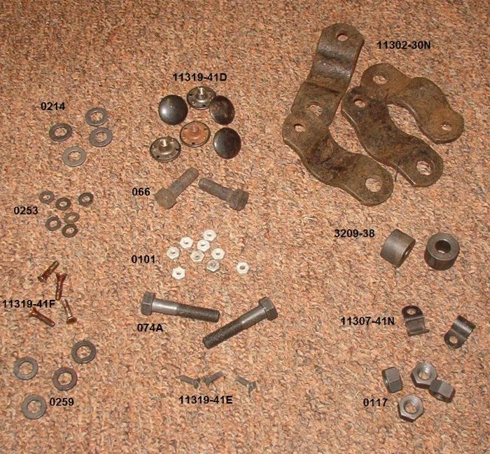

I recently turned my intention to the windshield parts again. Yeah.... I know... I am bouncing around again. :lol: What I have in windshield parts is shown in pic below. I will have to refinish some of the parts but several are in mint condition already. All are NOS OEM or OEM.
What I do not have in windshield parts are marked in red asterisks or outlined in red in the windshield parts illustration pic below.
I have an NOS OEM WLA windshield apron but it turns out it is a #58124-48, not the #11306-41BN apron I need. The one I have was used on 1950-1952 WLA’s. My NOS apron was also used on all Big Twin models 1940-1949, civilian 45 models 1950-1952, and Servi Car springer models 1953-1954. The only thing that makes my NOS apron a WLA apron is the olive drab color. If anyone has the apron I need and is willing to trade up evenly, give me a yell. Condition has to be good though and it must be OEM and olive drab. If I cannot find someone who will trade with me, My Ole Lady will throw it up on Ebay.

What’s the plan “B” in case this windshield isn’t out there?
