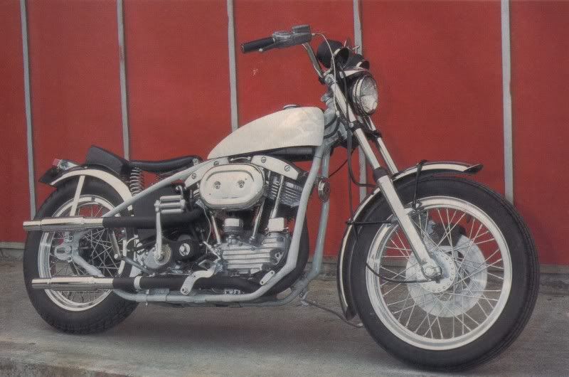

I found the magazine (an ancient issue of supercycle) I mentioned a while back that has the UL engine with a shovelhead top end.The article on it is pretty sparse but the following will give you the pertinent details.The cases only had to be slightly machined to accept the shovelhead topend,he used the stock UL tappet blocks but found that using sportster lifters gave the pushrods the right lift and length.The pushrod tubes look dead straight and centered in the grooves cut out of the cylinders fins for them.I'm sure they're probably off some but you can't see it in these pictures.He's running one of those aftermarket dual carb intakes with from what i can tell by what's not covered with a big oval aircleaner look like Amal carbs.Then other then a magneto and custom shotguns for exhaust it pretty much looks like your average stripped down UL.He stroked it to 88" to I quote "have a powerful V-twin engine with higher then normal torque characteristics and uses easier to find shovelhead parts".I wish I had a scanner but it's an old black and white photo anyway and wouldn't turn out very well.The same magazine has a 1928 JD owned by Buzz Walneck that's so nice it'll bring a tear to a grown mans eye.It's minus the front fender,has a cut down rear fender with a real sparto tail light,features some extra chrome and a late model paint scheme according to the text.He paid the tidy sum of $200.00 for it complete although in rough shape.I bet it took big balls to top out the 74" engine in what looks like amounts to a big bicycle back when the young and dumb or is that brave guys first bought them.

Joe Helfelrty at Williams Motors has built several of these engines for his customers. If ya want details he is your man.

I just spoke with Joe. He used the stock UL valve train. The lifter blocks were machined to accept the OHV cork seals. Sportster pushrod tubes were used as they has a smaller OD. It has been a long time ago (1970's) and he doesn't remember what rods and pistons were used. That shouldn't be hard to figure out. It was no race motor but did run and was seen running at least 15 years later.

dalaymond I have no scanner or it would be easy enough to put on my harddrive and share the article with all interested,I apologize for my inability to help.The article is VERY sparse on pictures as well as information.It's on 2 pages of the magazine but honestly didn't look to even need one full page for pictures and info provided.As to what pistons were used it doesn't doesn't any definitive answer.One could infer by the multiple mention of putting a shovelhead top end on a UL he used the complete shovelhead top end pistons included.That of course seems to be left up to the reader to know the writers definition of the terms he chose for said article such as "complete".
