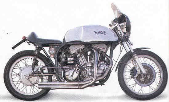

Found by Limey Dave; Norton frame, AJS/Matchless top end, 45 bottom end.
I remember this bike (or its twin) being featured in a copy of the 45 Club's magazine. Unfortunately the print quality was very poor, but I'll try and find it nonetheless.
Looks well put together but I think I'd be inclined to be a bit more imaginative with the exhausts!

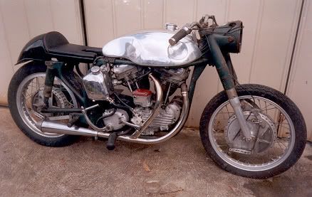

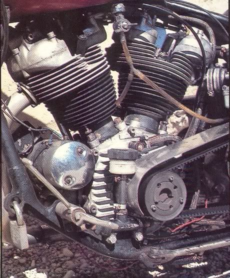

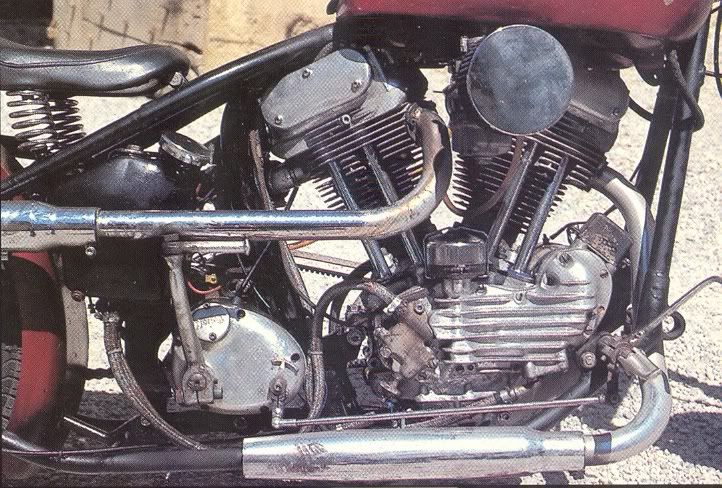

here's some pics I have collected over the years; the first one shows the cylinder mount detail if you look closely, seems to be a crude arrangement of keys gripping the cylinder base rim. I would guess that the cases are fly-cut so that the Matchless barrel spigots sit within the top of the cases
this one is a variation on the original theme;
this one, I think, is the original bike as shown in the magazine;

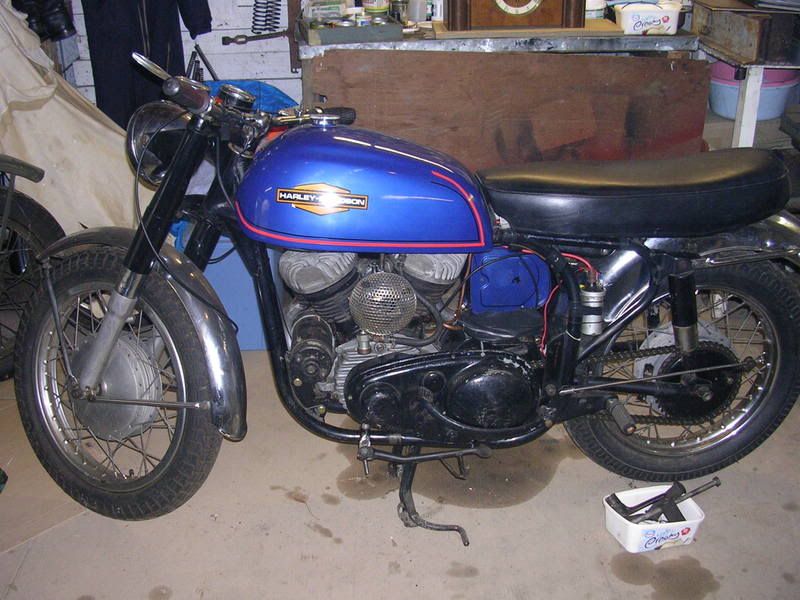

and this is a variant with the flathead enmgine in a Norton frame
they were never popular because the Norton frames were in too much demand for Tritons and TriBSAs!

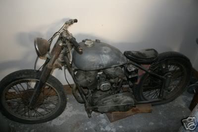

this one I have no idea about except that it appears to be an Indian Scout engine fitted with BMW top ends, so it is presumably a 500cc or 600cc unit, fitted into an Indian vertical-twin chassis

I don't see why the retaining keys idea wouldn't work, it's just that it would introduce a weak point by stressing the engine at a point where it isn't designed to be stressed. I've seen racing Rudge engines split at this point, cracked through above the barrel flange, and that's an engine which is designed that way.
My feeling would be that you would be best advised to weld up the original bolt holes, weld on a new bolt flange and drill and tap for a bolt circle to match the AMC ones.

Look at picture no 3 and 5 from top. Notice how the pushrod-angles are different. The top end seem to be rotated to align the angles on one of them.

I suspect that the red one has the front head rotated slightly to make the port angles work, it has 90 bends on both inlets and carbs both sides, which the Norton framed one doesn't.
